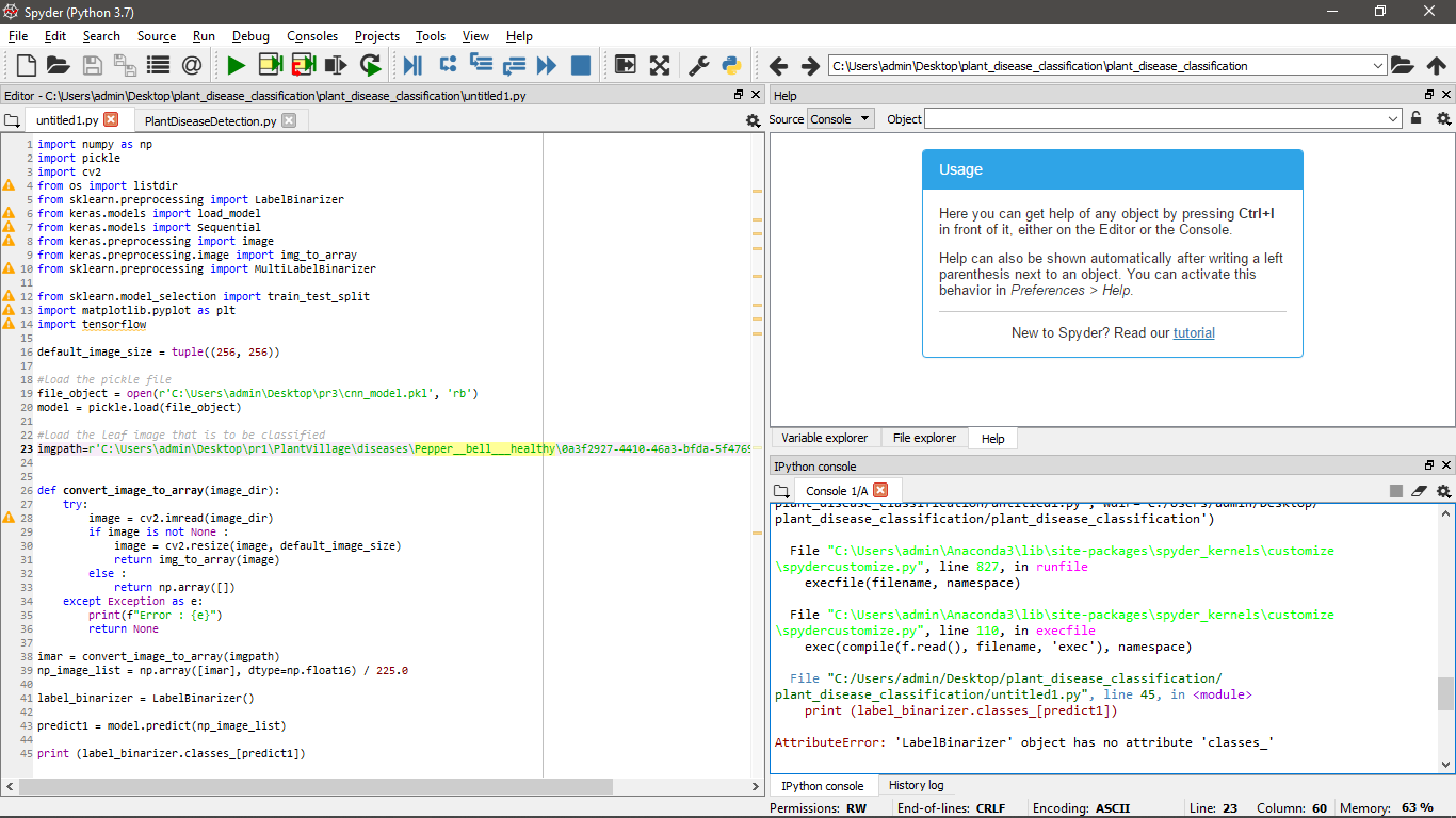

      The code given below is for image classification, it seems to be running well until the last iteration which gives the following error >
      "C:/Users/admin/Desktop/plant_disease_classification/plant_disease_classification/untitled1.py", line 45, in <module>
      print (label_binarizer.classes_[predict1])
      AttributeError: 'LabelBinarizer' object has no attribute 'classes_'

      the screenshot of the above complied code and error is uploaded for reference.

        @sreu13 said in leaf disease detection using keras:
        Hi, Can you try downgrade the scikit by typing
        pip install scikit-learn==0.15.2
        and are you following any guide or something, if yes can you share that also?

            SuperGops last edited by
            I think you need to use the fit or fit_transform function before you predict the classes and use the Binarizer. Have a look at scikit's official documentation for the same.
            https://scikit-learn.org/stable/modules/generated/sklearn.preprocessing.LabelBinarizer.html

              sreu13 @SuperGops last edited by
              @SuperGops
              i've entered this code,
              def fit_transform(self, n_classes):
              but as I run it, I get the indentation Error given below
              File"C:/Users/admin/Desktop/plant_disease_classification/plant_disease_classification/untitled1.py", line 42
              label_binarizer = LabelBinarizer()
              IndentationError: expected an indented block
              S 1 Reply Last reply Reply Quote 0
                SuperGops @sreu13 last edited by
                @sreu13
                fit and fit_transform are actually inbuilt functions found in the scikit-learn library. So I'd suggest you fit your model with the available data using those functions whose application can be found on scikit-learn's documentation and then proceed with the Binarizer.
                S 1 Reply Last reply Reply Quote 1
                  @SuperGops
                  so basically ,i'll have to restart and retrain the model with fit_transform?
                    @sreu13 Yup
