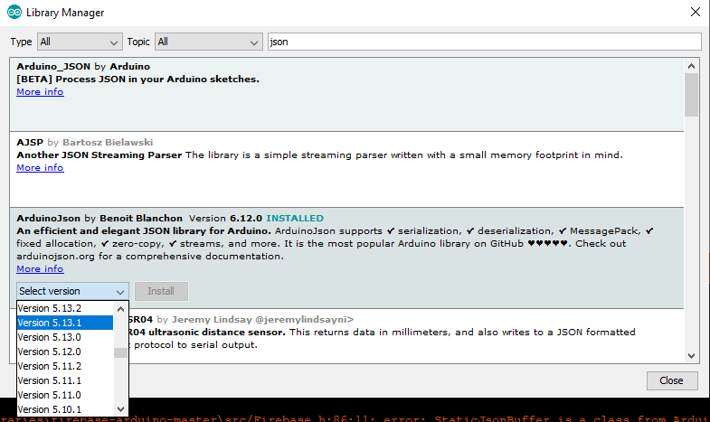

          Hi @Anudeep , Can you please share the error log details?
          If you are facing this error with the JSONBUFFER_SIZE like this
          lib\firebase-arduino-master\src\FirebaseObject.h:109:21: error: 'StaticJsonBuffer' was not declared in this scope
          std::shared_ptr<StaticJsonBuffer<FIREBASE_JSONBUFFER_SIZE>> buffer_;
          this is might be using the latetst ArduinoJson lib , so downgrade Arduinojson to the version 5.13.2. It will fix the issue
          Sketch -> Include libraries -> Manage libraries
          if the error persist please share the full error log so that we can understand it better .
