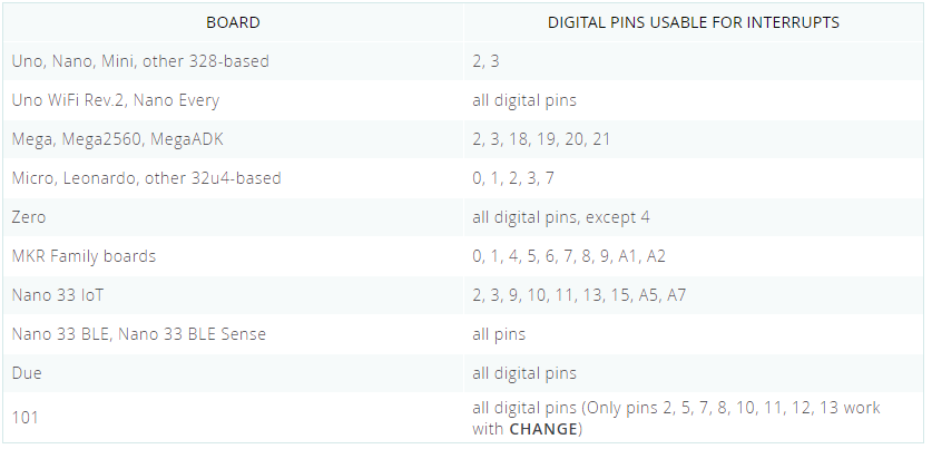

        Hi @SuperGops , All the digital pins of Arduino Due are capable of interrupts, and since you are using the Arduino framework everything is the same as Arduino Uno.
        more resource:
        • Arduino attachInterrupt()
        • What is interrupts ? by @rafitc99
