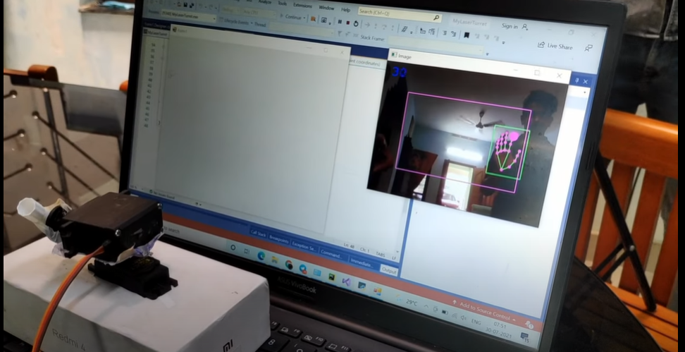

    @salmanfaris I mainly did this project by following two tutorials in youtube its link is mentioned in my channel.Basically it runs with the help of visual studio code and pycharm.Pycharm is used to detect the hand movement and with the helpm of autopy we move the mouse.By serial port cmmunication we can send the x,ycoordinates in to the arduino and move the servo
    read more
  • @athulkrishnakdlr Nice Project, Could you please share more about the technical aspects? What Dev kit are you using and how do you translate coordinates from OpenCV to the servo? Thanks 🙂👍.
    read more
    This is a gesture controlled laser turret,we can control the movement of laser by hand movement.With the help of OpenCV we move the mouse in computer by hand control

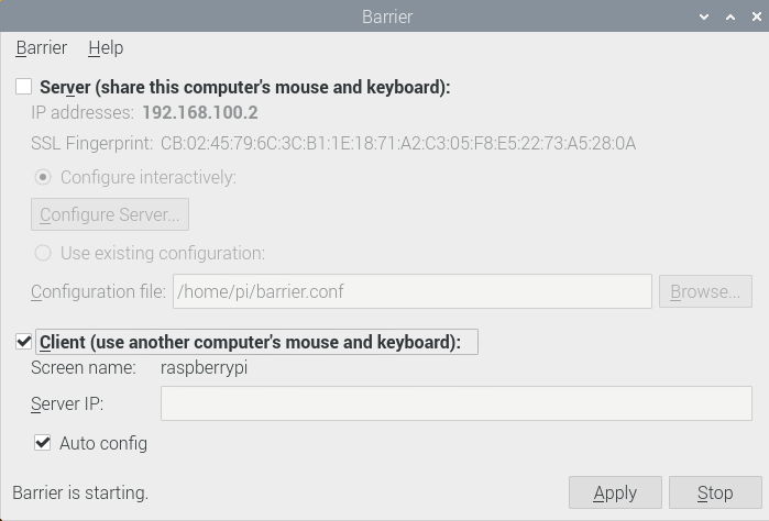

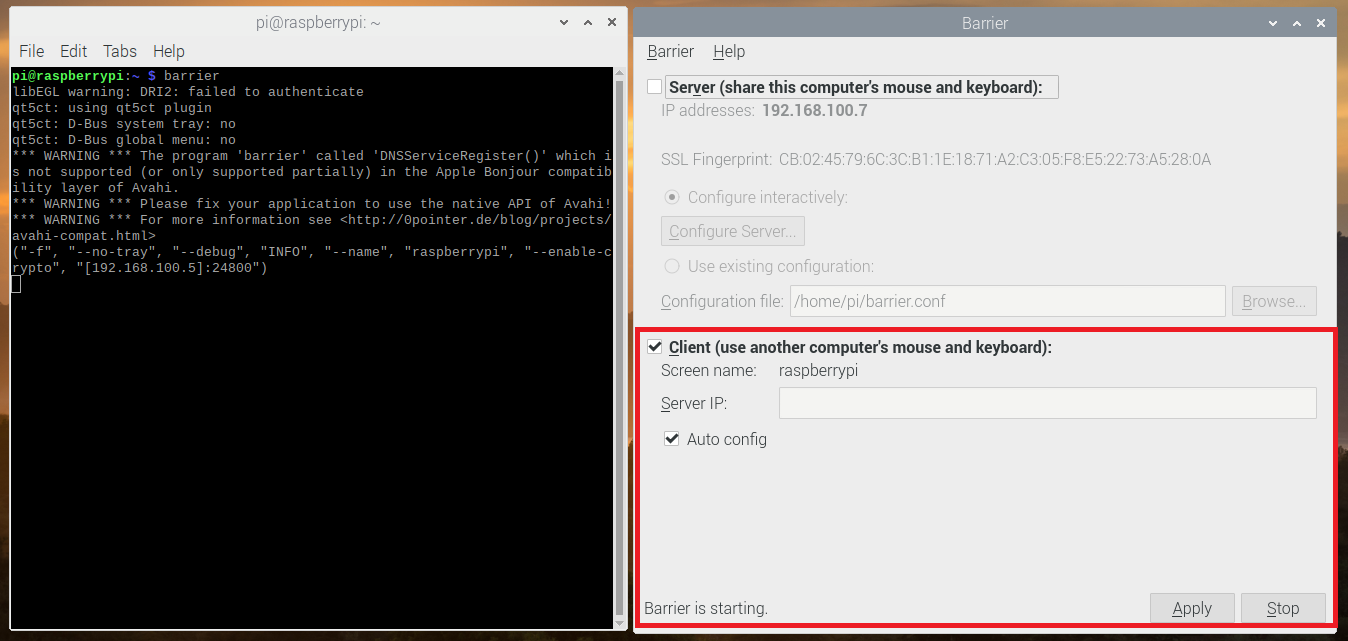

    Step 4: Setup barrier, Open barrier by typing barrier on the terminal, if you successfully installed the barrier you can see like this.
    Select option Client (Use another computer's mouse and keyboard) and Select Auto config option too, also note the Screen name, which we need for the server.

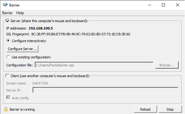

    Step 5: Download and Install barrier on desktop or laptop computer (The Server), download link

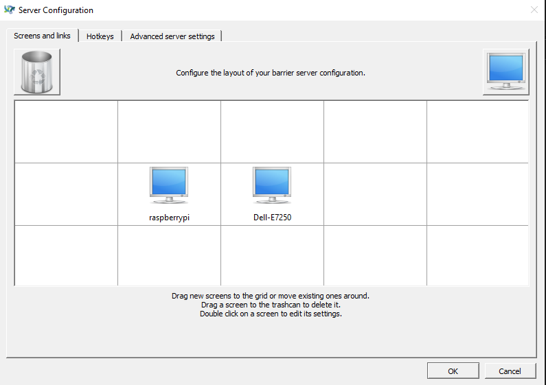

    Step 6: Set up the barrier by selecting Server and position your monitor on barrier software. 004.png

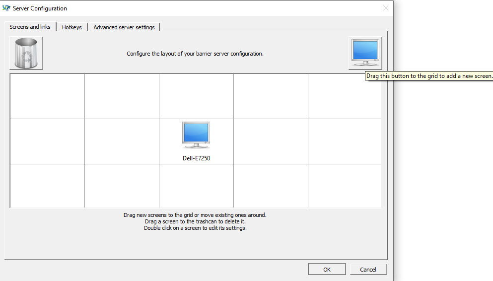

    To Position, the screen clicks the configure server.
    Here, to drag and drop the monitor icon to the desired position you need on the grid.

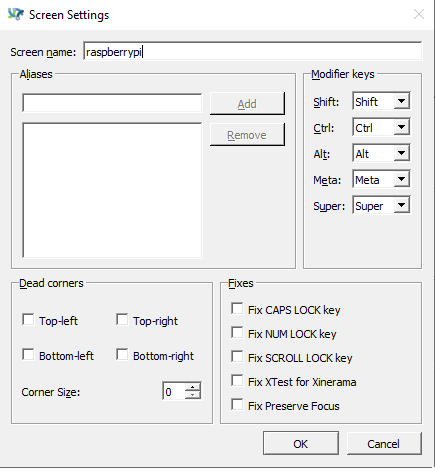

    double click the screen and set the screen name, you can obtain the screen name from the raspberry pi barrier client. (See Step 4)
    after setup, it should be like this. Then click OK
    in the following screen, click Apply and Just wait few seconds then try to move the mouse to the corner. Yes, It should work.
