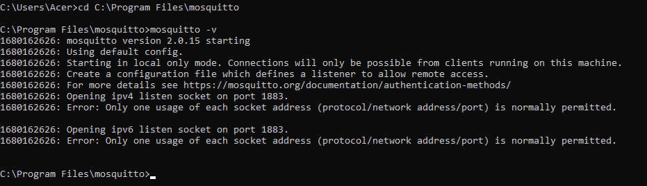

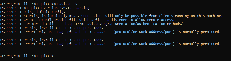

    • RE: Can't connect NodeMCU with MQTT
      @swalahamani @salmanfaris
      I changed my conf file and specified ipv4
      And this is the status of the port (from resource monitor):
      Image: mosquitto.exe
      PID: 3732
      Address: IPv6 loopback
      Protocol: TCP
      Port: 1883
      Firewall Status: Allowed, not restricted
      It is listening to mosquito..
      posted in Arduino
      S
      sivanath
      @salmanfaris It was working in CLI, but now it's showing multiple usages at the portmultiple usage.png

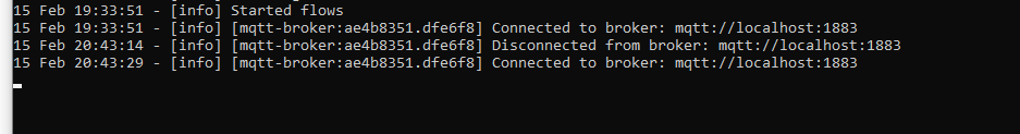

      @salmanfaris Yes, I had tried that before and it was working fine. Infact, everything works perfectly when I connect with the online mqtt server, test.mosquitto.org. So, there's some problem with the local installation, while using my local IP. But I can't find that problem. I had also re-installed the mqtt, but still the same issue.
      posted in Arduino
      S
      sivanath
      @salmanfaris It is running locally on my computer. Yes, and is running in the background.

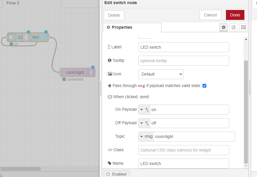

      sivanath
    • Can't connect NodeMCU with MQTT
      I can't establish a connection with my NodeMCU and MQTT server.
      I am getting an error of:
      Attempting MQTT connection...failed, rc=-2 try again in 5 seconds
