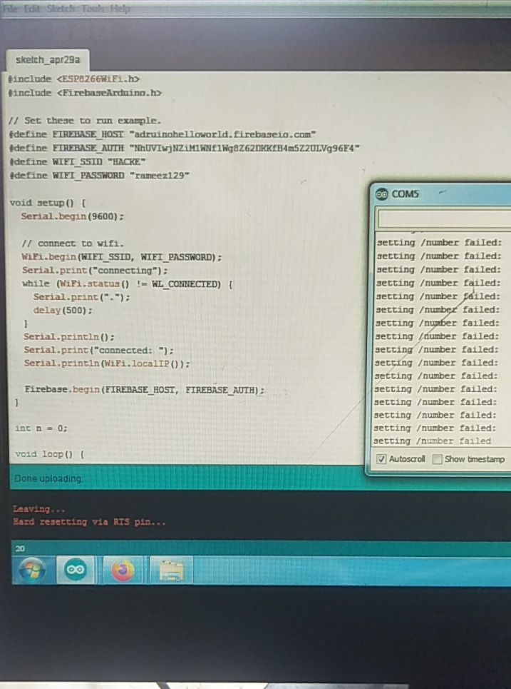

      Could you help me?
      I have pull hello to firebase using nodemcu connected to server but unfortutently it show a error like this some many i search in google
      Try all things in the link also but error didn't change
      https://github.com/FirebaseExtended/firebase-arduino/issues/315
      rafitc99 1 Reply Last reply Reply Quote 0
        Hi @mhmdrameez , Can you share full error log here? and also don't forget to hide the credentials when posting!

          @mhmdrameez I used that library before 6 Month ago and Worked fine. But now, it's not working. I think there are some issues with the library. Because there are somany open issues in GitHub Repo.
          But while trying with Firebase ESP8299 Client library, which is listed on Arduino library manager it's worked fine for me. So, make a try using this library.
          Library: Tools >> Manage Library > search for firebase esp8266
