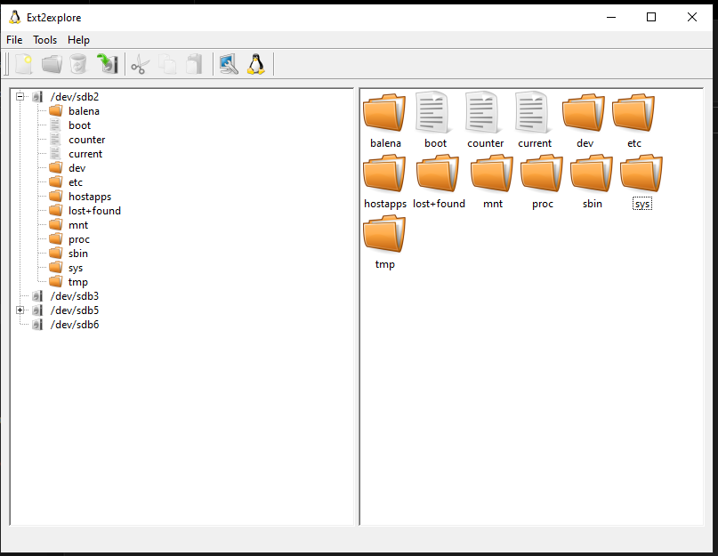

        Thanks for the tip @Abhay. keep in mind, after flashing the OS to the SD card, it will not open the window machine because Windows is only able to manage only its own partitions (fat16, fat32, ntfs, exfat).
        so you need to software that can read Linux ext format for you, I used Ext2Read, and it does the job.
        Abhay 1 Reply Last reply Reply Quote 2

          @salmanfaris Thanks for reminding about windows machine partitions and insight about using Ext2Read.
