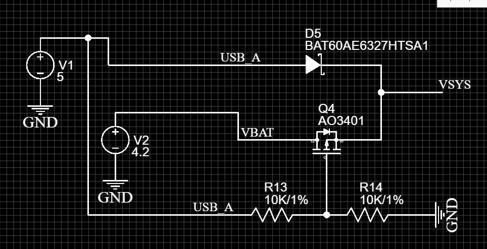

      Thanks for your amazing explanations... but still not done yet
      i have this power switching circuit
      i have a little doubt about the mosfet in the circuit basically when there is a voltage in the V1(5v) it gets divided before going to the gate then the gate turns on the mosfet that is the USB(V1) power is used by the device, what i dont understand is the VBAT(V2) should be connect to the drain or source of the mosfet, i think it should be the source but there is a diode between the drain and the source which will be forward bias if current is flowing from the drain(I might be wrong), which mean current wont flow from source to the drain.

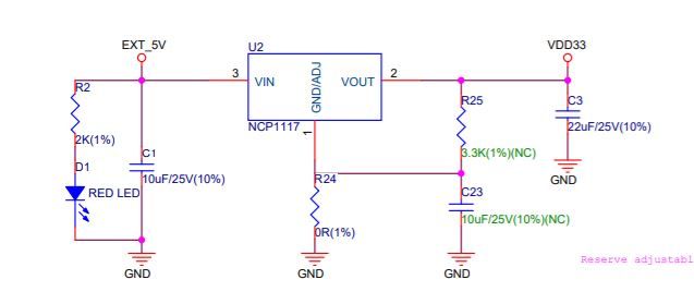

      Thanks for your kind explanations, but in that circuit it already have an input EXT_5V capacitor C1 which is 10uF and a output of 22uF at c3 before going to power VDD33, my question here is the R25 resistor and R24(what does 0R even mean) and C23 capacitor are they really needed in the circuit? i mean if like you said every ic on a pcb board take little bit of power so why populate it with unnecessary resistors and capacitors. and also how can i simulate this link text circuit, i am still looking for simulation mode on easyeda for the past 2 days... still looking...

      thanks for the answers @kowshik1729 but before you answer the remaining question i have some few more,
      in this schematic 3.3K(1%)(NC) and 10uF/25V(10%)(NC) i assume that they do not need to be connected, Is that correct?

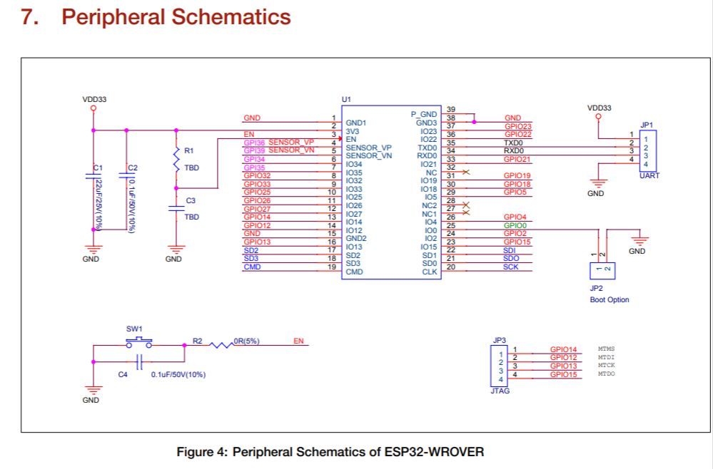

    • RE: Schematic Design For esp32
      @kowshik1729 said in Schematic Design For esp32:
      JTAG connections
      i am trying to make the pcb as slim as possible here and adding the jumper will make it a little bigger width wise, i thought the the UART(JP1) is for uploading the code to the esp module as it is connected to TXDO and RXDO or is it only serving as a power connect in this schematic?

      Thanks for the replies.. so far i have been able to achieve this link text but i am having so doubts when following the datasheet of link text page 15 here is the image Esp32-Schematic.JPG , I do not understand what the JP3(Jtage) is for, can someone please explain, also i have this other link link text he did the same thing am doing but way more than mine. so i am following some of his schematics. also i have a lot of unfinished net in my schematic please how do i deal with them... Thanks
