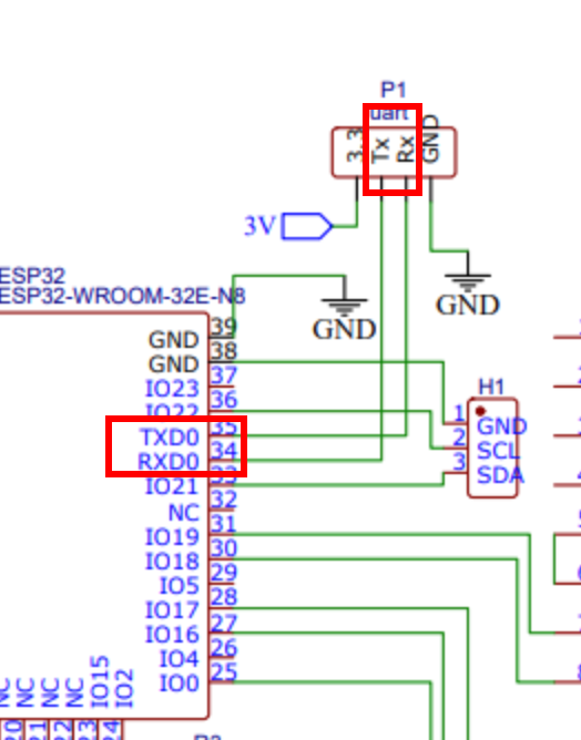

      This is the schematic i used

        salmanfaris @Richu Bini last edited by
        Hi @Richu-Bini , What kind of UART/FTDI programmer you are using? Could also share the connection diagram to the module with the programmer?
        and in the diagram I see, you already twisted Rx and Tx, so you should connect the FTDI with the module Esp32 Rx - FTDI Rx and Esp32 TX - FTDI TX.

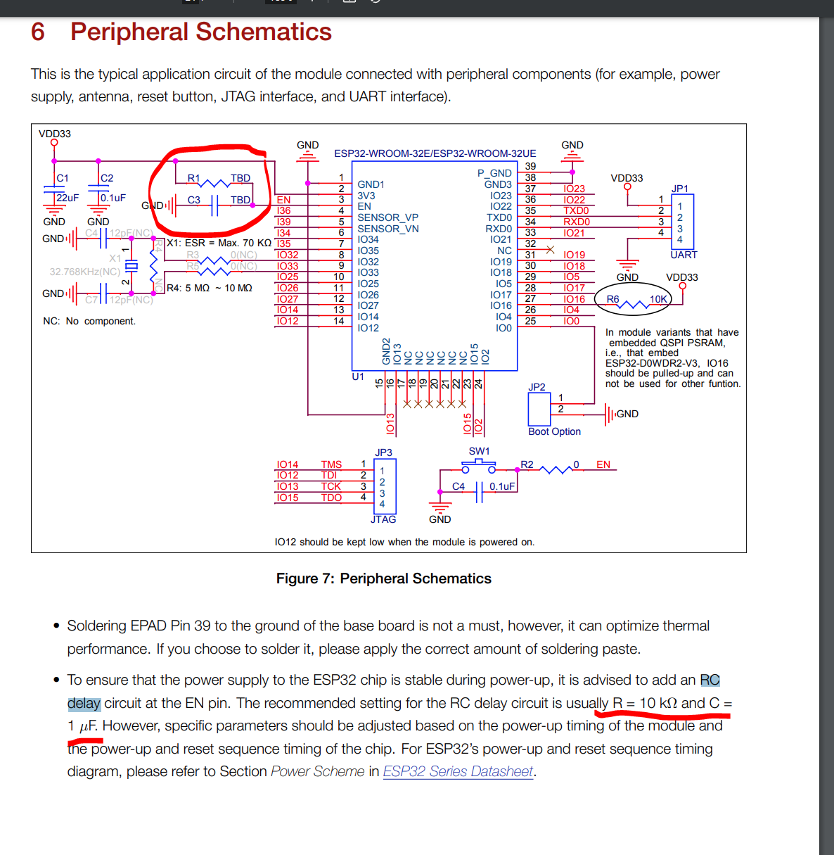

            aneeshprasobhan @Richu Bini last edited by
            @Richu-Bini I'm not sure if this is the root cause but normally, you should add an RC delay on the EN pin. This is because the BOOT pin should reach 3.3V before the EN reaches 3.3V hence, the RC delay on the EN pin. A 10K resistor and a 1μF Cap should do it. Here's a sketch on how it should look like:
            Here is the part in the datasheet of the WROOM32 that tells you to do it:
