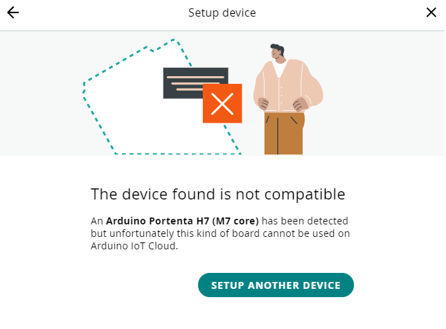

    No support for Arduino portenta H7 support with arduino IOT cloud
    Arduino
    747
      Did anyone use Arduino Portenta H7 with Arduino IOT Cloud? It is listed on IOT Cloud Page but it's not supporting!
      When I was trying to connect the board with the, it says The device found is not compatible
      But it's listed in the supporting board page.

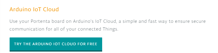

      also mentioned in the portenta page .
      • https://www.arduino.cc/en/IoT/HomePage
      • https://store.arduino.cc/usa/portenta-h7

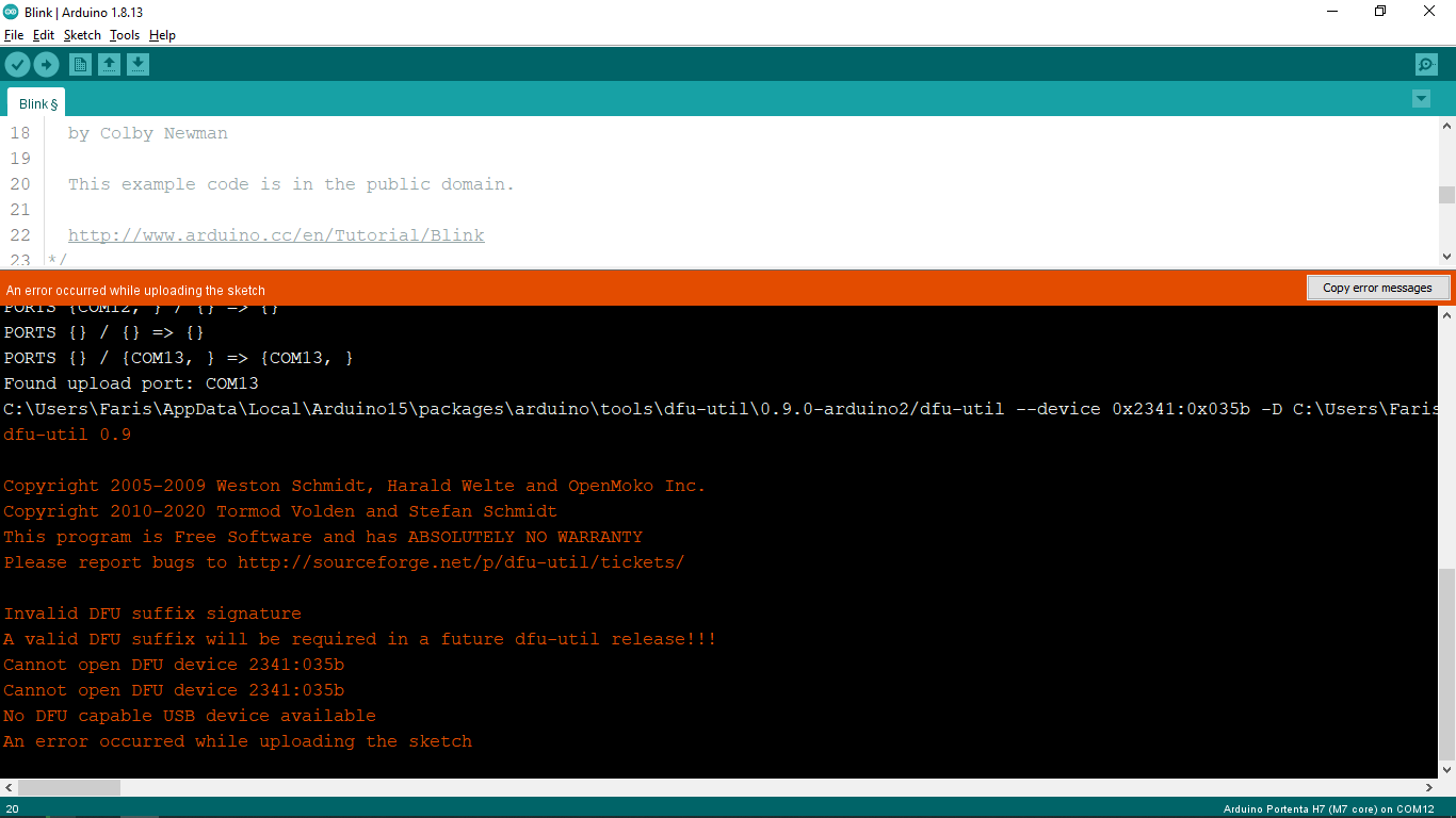

        Trying to run blink on portenta but getting the error?
        error message:
        Arduino: 1.8.13 (Windows 10), Board: "Arduino Portenta H7 (M7 core)"
        C:\Program Files (x86)\Arduino\arduino-builder -dump-prefs -logger=machine -hardware C:\Program Files (x86)\Arduino\hardware -hardware C:\Users\Faris\AppData\Local\Arduino15\packages -tools C:\Program Files (x86)\Arduino\tools-builder -tools C:\Program Files (x86)\Arduino\hardware\tools\avr -tools C:\Users\Faris\AppData\Local\Arduino15\packages -built-in-libraries C:\Program Files (x86)\Arduino\libraries -libraries C:\Users\Faris\Documents\Arduino\libraries -fqbn=arduino:mbed:envie_m7 -vid-pid=2341_025B -ide-version=10813 -build-path C:\Users\Faris\AppData\Local\Temp\arduino_build_650727 -warnings=none -build-cache C:\Users\Faris\AppData\Local\Temp\arduino_cache_409352 -prefs=build.warn_data_percentage=75 -prefs=runtime.tools.arm-none-eabi-gcc.path=C:\Users\Faris\AppData\Local\Arduino15\packages\arduino\tools\arm-none-eabi-gcc\7-2017q4 -prefs=runtime.tools.arm-none-eabi-gcc-7-2017q4.path=C:\Users\Faris\AppData\Local\Arduino15\packages\arduino\tools\arm-none-eabi-gcc\7-2017q4 -prefs=runtime.tools.bossac.path=C:\Users\Faris\AppData\Local\Arduino15\packages\arduino\tools\bossac\1.9.1-arduino2 -prefs=runtime.tools.bossac-1.9.1-arduino2.path=C:\Users\Faris\AppData\Local\Arduino15\packages\arduino\tools\bossac\1.9.1-arduino2 -prefs=runtime.tools.openocd.path=C:\Users\Faris\AppData\Local\Arduino15\packages\arduino\tools\openocd\0.10.0-arduino13 -prefs=runtime.tools.openocd-0.10.0-arduino13.path=C:\Users\Faris\AppData\Local\Arduino15\packages\arduino\tools\openocd\0.10.0-arduino13 -prefs=runtime.tools.dfu-util.path=C:\Users\Faris\AppData\Local\Arduino15\packages\arduino\tools\dfu-util\0.9.0-arduino2 -prefs=runtime.tools.dfu-util-0.9.0-arduino2.path=C:\Users\Faris\AppData\Local\Arduino15\packages\arduino\tools\dfu-util\0.9.0-arduino2 -verbose C:\Users\Faris\AppData\Local\Temp\arduino_modified_sketch_49117\Blink.ino
        C:\Program Files (x86)\Arduino\arduino-builder -compile -logger=machine -hardware C:\Program Files (x86)\Arduino\hardware -hardware C:\Users\Faris\AppData\Local\Arduino15\packages -tools C:\Program Files (x86)\Arduino\tools-builder -tools C:\Program Files (x86)\Arduino\hardware\tools\avr -tools C:\Users\Faris\AppData\Local\Arduino15\packages -built-in-libraries C:\Program Files (x86)\Arduino\libraries -libraries C:\Users\Faris\Documents\Arduino\libraries -fqbn=arduino:mbed:envie_m7 -vid-pid=2341_025B -ide-version=10813 -build-path C:\Users\Faris\AppData\Local\Temp\arduino_build_650727 -warnings=none -build-cache C:\Users\Faris\AppData\Local\Temp\arduino_cache_409352 -prefs=build.warn_data_percentage=75 -prefs=runtime.tools.arm-none-eabi-gcc.path=C:\Users\Faris\AppData\Local\Arduino15\packages\arduino\tools\arm-none-eabi-gcc\7-2017q4 -prefs=runtime.tools.arm-none-eabi-gcc-7-2017q4.path=C:\Users\Faris\AppData\Local\Arduino15\packages\arduino\tools\arm-none-eabi-gcc\7-2017q4 -prefs=runtime.tools.bossac.path=C:\Users\Faris\AppData\Local\Arduino15\packages\arduino\tools\bossac\1.9.1-arduino2 -prefs=runtime.tools.bossac-1.9.1-arduino2.path=C:\Users\Faris\AppData\Local\Arduino15\packages\arduino\tools\bossac\1.9.1-arduino2 -prefs=runtime.tools.openocd.path=C:\Users\Faris\AppData\Local\Arduino15\packages\arduino\tools\openocd\0.10.0-arduino13 -prefs=runtime.tools.openocd-0.10.0-arduino13.path=C:\Users\Faris\AppData\Local\Arduino15\packages\arduino\tools\openocd\0.10.0-arduino13 -prefs=runtime.tools.dfu-util.path=C:\Users\Faris\AppData\Local\Arduino15\packages\arduino\tools\dfu-util\0.9.0-arduino2 -prefs=runtime.tools.dfu-util-0.9.0-arduino2.path=C:\Users\Faris\AppData\Local\Arduino15\packages\arduino\tools\dfu-util\0.9.0-arduino2 -verbose C:\Users\Faris\AppData\Local\Temp\arduino_modified_sketch_49117\Blink.ino
        Using board 'envie_m7' from platform in folder: C:\Users\Faris\AppData\Local\Arduino15\packages\arduino\hardware\mbed\1.3.1
        Using core 'arduino' from platform in folder: C:\Users\Faris\AppData\Local\Arduino15\packages\arduino\hardware\mbed\1.3.1
        Detecting libraries used...
        "C:\\Users\\Faris\\AppData\\Local\\Arduino15\\packages\\arduino\\tools\\arm-none-eabi-gcc\\7-2017q4/bin/arm-none-eabi-g++" -c -w -g -Os -nostdlib "@C:\\Users\\Faris\\AppData\\Local\\Arduino15\\packages\\arduino\\hardware\\mbed\\1.3.1\\variants\\PORTENTA_H7_M7/defines.txt" "@C:\\Users\\Faris\\AppData\\Local\\Arduino15\\packages\\arduino\\hardware\\mbed\\1.3.1\\variants\\PORTENTA_H7_M7/cxxflags.txt" -mcpu=cortex-m7 -mfloat-abi=softfp -mfpu=fpv5-d16 -w -x c++ -E -CC -DARDUINO=10813 -DARDUINO_PORTENTA_H7_M7 -DARDUINO_ARCH_MBED -DARDUINO_LIBRARY_DISCOVERY_PHASE=0 "-IC:\\Users\\Faris\\AppData\\Local\\Arduino15\\packages\\arduino\\hardware\\mbed\\1.3.1\\cores\\arduino" "-IC:\\Users\\Faris\\AppData\\Local\\Arduino15\\packages\\arduino\\hardware\\mbed\\1.3.1\\variants\\PORTENTA_H7_M7" "-IC:\\Users\\Faris\\AppData\\Local\\Arduino15\\packages\\arduino\\hardware\\mbed\\1.3.1\\cores\\arduino/api/deprecated" "-iprefixC:\\Users\\Faris\\AppData\\Local\\Arduino15\\packages\\arduino\\hardware\\mbed\\1.3.1\\cores\\arduino" "@C:\\Users\\Faris\\AppData\\Local\\Arduino15\\packages\\arduino\\hardware\\mbed\\1.3.1\\variants\\PORTENTA_H7_M7/includes.txt" "C:\\Users\\Faris\\AppData\\Local\\Temp\\arduino_build_650727\\sketch\\Blink.ino.cpp" -o nul -DARDUINO_LIB_DISCOVERY_PHASE
        Generating function prototypes...
        "C:\\Users\\Faris\\AppData\\Local\\Arduino15\\packages\\arduino\\tools\\arm-none-eabi-gcc\\7-2017q4/bin/arm-none-eabi-g++" -c -w -g -Os -nostdlib "@C:\\Users\\Faris\\AppData\\Local\\Arduino15\\packages\\arduino\\hardware\\mbed\\1.3.1\\variants\\PORTENTA_H7_M7/defines.txt" "@C:\\Users\\Faris\\AppData\\Local\\Arduino15\\packages\\arduino\\hardware\\mbed\\1.3.1\\variants\\PORTENTA_H7_M7/cxxflags.txt" -mcpu=cortex-m7 -mfloat-abi=softfp -mfpu=fpv5-d16 -w -x c++ -E -CC -DARDUINO=10813 -DARDUINO_PORTENTA_H7_M7 -DARDUINO_ARCH_MBED -DARDUINO_LIBRARY_DISCOVERY_PHASE=0 "-IC:\\Users\\Faris\\AppData\\Local\\Arduino15\\packages\\arduino\\hardware\\mbed\\1.3.1\\cores\\arduino" "-IC:\\Users\\Faris\\AppData\\Local\\Arduino15\\packages\\arduino\\hardware\\mbed\\1.3.1\\variants\\PORTENTA_H7_M7" "-IC:\\Users\\Faris\\AppData\\Local\\Arduino15\\packages\\arduino\\hardware\\mbed\\1.3.1\\cores\\arduino/api/deprecated" "-iprefixC:\\Users\\Faris\\AppData\\Local\\Arduino15\\packages\\arduino\\hardware\\mbed\\1.3.1\\cores\\arduino" "@C:\\Users\\Faris\\AppData\\Local\\Arduino15\\packages\\arduino\\hardware\\mbed\\1.3.1\\variants\\PORTENTA_H7_M7/includes.txt" "C:\\Users\\Faris\\AppData\\Local\\Temp\\arduino_build_650727\\sketch\\Blink.ino.cpp" -o "C:\\Users\\Faris\\AppData\\Local\\Temp\\arduino_build_650727\\preproc\\ctags_target_for_gcc_minus_e.cpp" -DARDUINO_LIB_DISCOVERY_PHASE
        "C:\\Program Files (x86)\\Arduino\\tools-builder\\ctags\\5.8-arduino11/ctags" -u --language-force=c++ -f - --c++-kinds=svpf --fields=KSTtzns --line-directives "C:\\Users\\Faris\\AppData\\Local\\Temp\\arduino_build_650727\\preproc\\ctags_target_for_gcc_minus_e.cpp"
        Compiling sketch...
        "C:\\Users\\Faris\\AppData\\Local\\Arduino15\\packages\\arduino\\tools\\arm-none-eabi-gcc\\7-2017q4/bin/arm-none-eabi-g++" -c -w -g -Os -nostdlib "@C:\\Users\\Faris\\AppData\\Local\\Arduino15\\packages\\arduino\\hardware\\mbed\\1.3.1\\variants\\PORTENTA_H7_M7/defines.txt" "@C:\\Users\\Faris\\AppData\\Local\\Arduino15\\packages\\arduino\\hardware\\mbed\\1.3.1\\variants\\PORTENTA_H7_M7/cxxflags.txt" -MMD -mcpu=cortex-m7 -mfloat-abi=softfp -mfpu=fpv5-d16 -DARDUINO=10813 -DARDUINO_PORTENTA_H7_M7 -DARDUINO_ARCH_MBED -DARDUINO_LIBRARY_DISCOVERY_PHASE=0 "-IC:\\Users\\Faris\\AppData\\Local\\Arduino15\\packages\\arduino\\hardware\\mbed\\1.3.1\\cores\\arduino" "-IC:\\Users\\Faris\\AppData\\Local\\Arduino15\\packages\\arduino\\hardware\\mbed\\1.3.1\\variants\\PORTENTA_H7_M7" "-IC:\\Users\\Faris\\AppData\\Local\\Arduino15\\packages\\arduino\\hardware\\mbed\\1.3.1\\cores\\arduino/api/deprecated" "-iprefixC:\\Users\\Faris\\AppData\\Local\\Arduino15\\packages\\arduino\\hardware\\mbed\\1.3.1\\cores\\arduino" "@C:\\Users\\Faris\\AppData\\Local\\Arduino15\\packages\\arduino\\hardware\\mbed\\1.3.1\\variants\\PORTENTA_H7_M7/includes.txt" "C:\\Users\\Faris\\AppData\\Local\\Temp\\arduino_build_650727\\sketch\\Blink.ino.cpp" -o "C:\\Users\\Faris\\AppData\\Local\\Temp\\arduino_build_650727\\sketch\\Blink.ino.cpp.o"
        Compiling libraries...
        Compiling core...
        Using previously compiled file: C:\Users\Faris\AppData\Local\Temp\arduino_build_650727\core\variant.cpp.o
        Using precompiled core: C:\Users\Faris\AppData\Local\Temp\arduino_cache_409352\core\core_arduino_mbed_envie_m7_e26c816eecbb9bfaaa432fd6b53eb31d.a
        Linking everything together...
        "C:\\Users\\Faris\\AppData\\Local\\Arduino15\\packages\\arduino\\tools\\arm-none-eabi-gcc\\7-2017q4/bin/arm-none-eabi-g++" "-LC:\\Users\\Faris\\AppData\\Local\\Temp\\arduino_build_650727" -Wl,--gc-sections -w -Wl,--as-needed "@C:\\Users\\Faris\\AppData\\Local\\Arduino15\\packages\\arduino\\hardware\\mbed\\1.3.1\\variants\\PORTENTA_H7_M7/ldflags.txt" "-TC:\\Users\\Faris\\AppData\\Local\\Arduino15\\packages\\arduino\\hardware\\mbed\\1.3.1\\variants\\PORTENTA_H7_M7/linker_script.ld" "-Wl,-Map,C:\\Users\\Faris\\AppData\\Local\\Temp\\arduino_build_650727/Blink.ino.map" --specs=nosys.specs -o "C:\\Users\\Faris\\AppData\\Local\\Temp\\arduino_build_650727/Blink.ino.elf" "C:\\Users\\Faris\\AppData\\Local\\Temp\\arduino_build_650727\\sketch\\Blink.ino.cpp.o" "C:\\Users\\Faris\\AppData\\Local\\Temp\\arduino_build_650727\\core\\variant.cpp.o" -Wl,--whole-archive "C:\\Users\\Faris\\AppData\\Local\\Temp\\arduino_build_650727/..\\arduino_cache_409352\\core\\core_arduino_mbed_envie_m7_e26c816eecbb9bfaaa432fd6b53eb31d.a" "C:\\Users\\Faris\\AppData\\Local\\Arduino15\\packages\\arduino\\hardware\\mbed\\1.3.1\\variants\\PORTENTA_H7_M7/libs/libmbed.a" -Wl,--no-whole-archive -Wl,--start-group -lstdc++ -lsupc++ -lm -lc -lgcc -lnosys -Wl,--end-group
        "C:\\Users\\Faris\\AppData\\Local\\Arduino15\\packages\\arduino\\tools\\arm-none-eabi-gcc\\7-2017q4/bin/arm-none-eabi-objcopy" -O binary "C:\\Users\\Faris\\AppData\\Local\\Temp\\arduino_build_650727/Blink.ino.elf" "C:\\Users\\Faris\\AppData\\Local\\Temp\\arduino_build_650727/Blink.ino.bin"
        "C:\\Users\\Faris\\AppData\\Local\\Arduino15\\packages\\arduino\\tools\\arm-none-eabi-gcc\\7-2017q4/bin/arm-none-eabi-objcopy" -O ihex -R .eeprom "C:\\Users\\Faris\\AppData\\Local\\Temp\\arduino_build_650727/Blink.ino.elf" "C:\\Users\\Faris\\AppData\\Local\\Temp\\arduino_build_650727/Blink.ino.hex"
        "C:\\Users\\Faris\\AppData\\Local\\Arduino15\\packages\\arduino\\tools\\arm-none-eabi-gcc\\7-2017q4/bin/arm-none-eabi-size" -A "C:\\Users\\Faris\\AppData\\Local\\Temp\\arduino_build_650727/Blink.ino.elf"
        Sketch uses 130248 bytes (16%) of program storage space. Maximum is 786432 bytes.
        Global variables use 57280 bytes (10%) of dynamic memory, leaving 466344 bytes for local variables. Maximum is 523624 bytes.
        Forcing reset using 1200bps open/close on port COM12
        PORTS {COM12, } / {} => {}
        PORTS {} / {} => {}
        PORTS {} / {COM13, } => {COM13, }
        Found upload port: COM13
        C:\Users\Faris\AppData\Local\Arduino15\packages\arduino\tools\dfu-util\0.9.0-arduino2/dfu-util --device 0x2341:0x035b -D C:\Users\Faris\AppData\Local\Temp\arduino_build_650727/Blink.ino.bin -a0 --dfuse-address=0x08040000:leave
        dfu-util 0.9
        Copyright 2005-2009 Weston Schmidt, Harald Welte and OpenMoko Inc.
        Copyright 2010-2020 Tormod Volden and Stefan Schmidt
        This program is Free Software and has ABSOLUTELY NO WARRANTY
        Please report bugs to http://sourceforge.net/p/dfu-util/tickets/
        Invalid DFU suffix signature
        A valid DFU suffix will be required in a future dfu-util release!!!
        Cannot open DFU device 2341:035b
        No DFU capable USB device available
        An error occurred while uploading the sketch

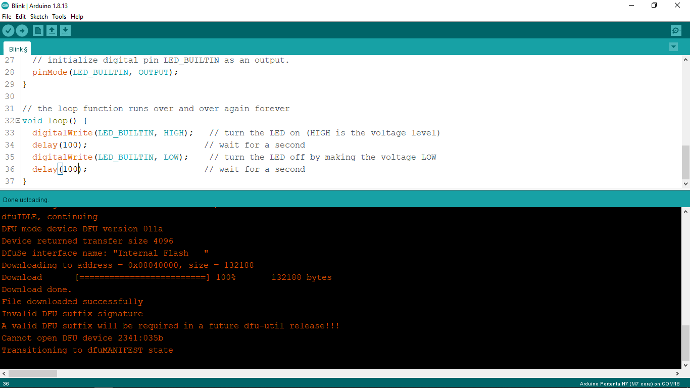

          After reinstalling the portenta board file and restarting the computer, solved the problem.
