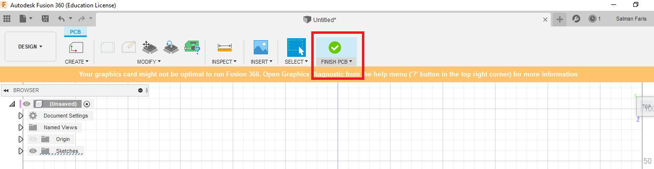

        Step 1: Create Fusion360 design

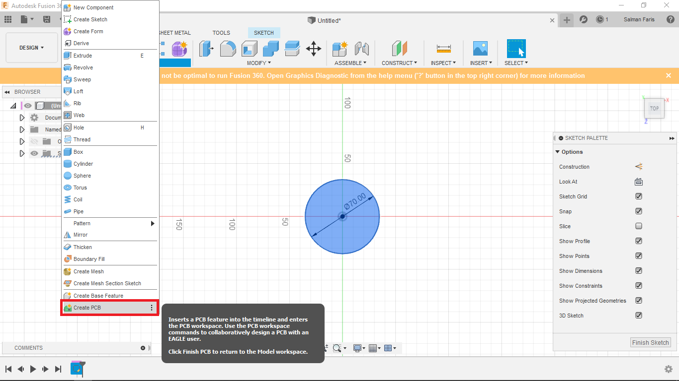

        Step 2: Select Creat PCB from Creat -> Create PCB
        Step 3: Click Create PCB Profile
        Step 4: Click Finish PCB and Save to Fusion

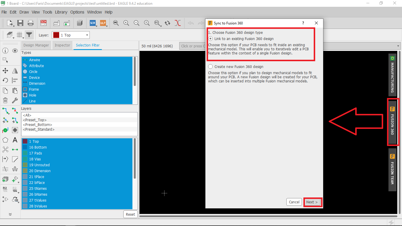

        Step 5: Open Eagle and Sign with the same account that used Fusion360
        Step 6: Open Board Design file and Select Fusion360 Icon on the right side and Select Option One that links to existing fusion design

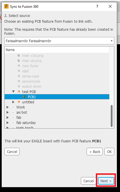

        Step 7: Select Fusion Project from the following project list and select the PCB file

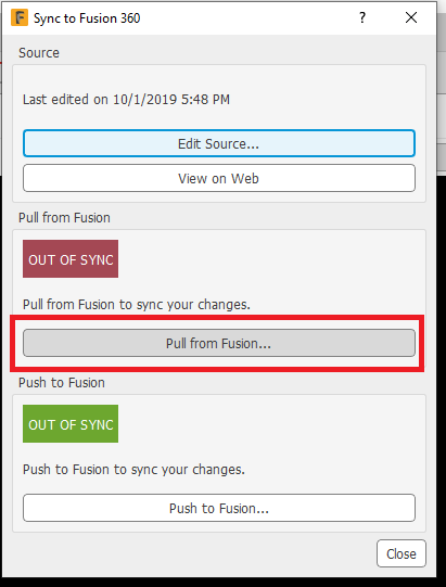

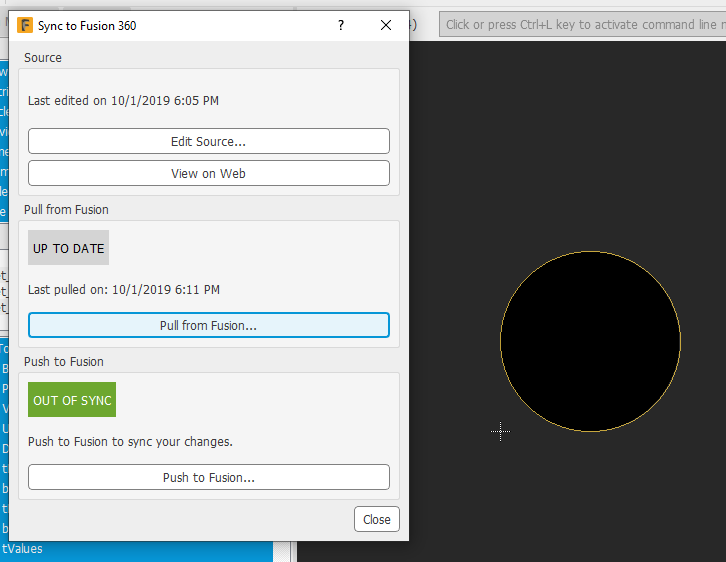

        Step 8: Click Pull From Fusion to Sync the design with Eagle
        Step 9: If everything done perfectly you can see the PCB board outline in eagle
