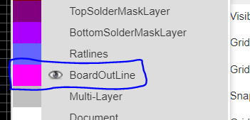

              2. On the top right corner you can find the layer selection . Selection "Board Outline" alone to make it active layer. The eye symbol and pencil symbol must be on the same layer.

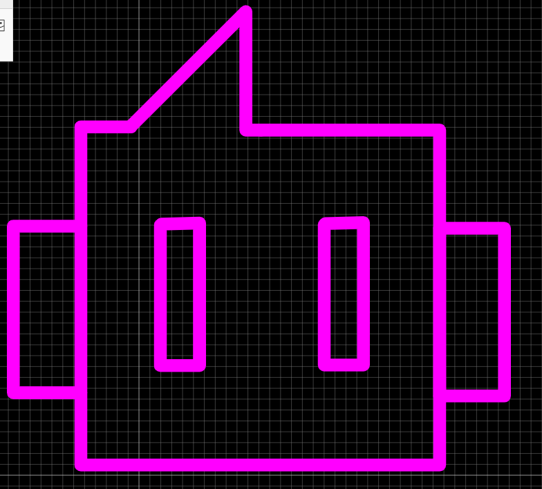

              3. Now, you can draw any shape by using the tools available on the screen. They look something as shown below,

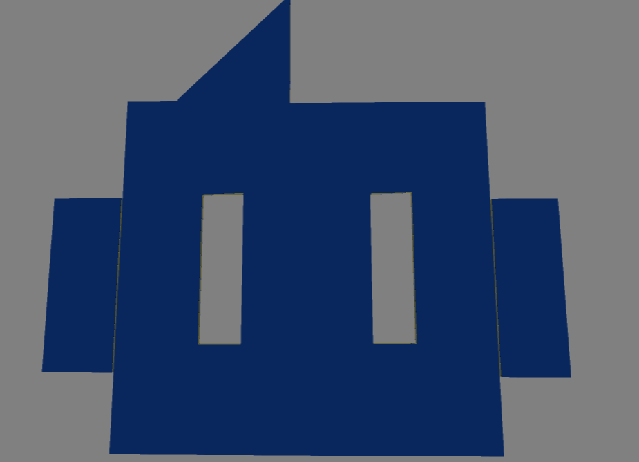

              4. I made makergram shape as shown below.
              1. It even offers a 3D view where you can get by clicking on the camera symbol in the toolbar.
