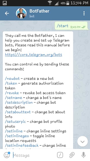

Download from here: Telegram1.2 Start "BotFather"
1.3 Open "BotFather"
1.4 Start "BotFather"
1.5 Create a new Bot
Add an imageDelete this imageBot: Salmanfaris_bot1.6 Obtain access token
